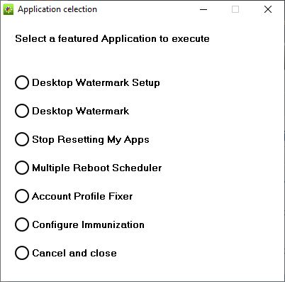

RebootExec does a lot of things. Besides many commands that are executed on reboot, it also contains the code for Desktop Watermark, Stop Resetting My Apps, Multiple Reboot Scheduler, Account Profile Fixer, Configure Immunization and others. When executed without command line parameters it will show a dialog box letting users select the desired app to run. I'm sure you'll be happy with this.

Do you mean by "it *will* show a dialog" that you're talking about a future version of it?
Re: Rebootexec - could it run the watermark without the parameter?
Hi Xander. Sorry I didn't get a notification about your last post.
Yes, I created that dialog box in the last update. It's working fine for me.
MRS and APF do not depend on RebootExec. But RebootExec contains their code, so it can do all the things they do.
