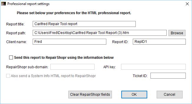

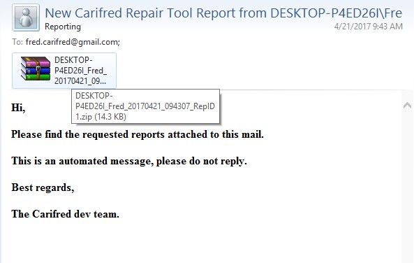

Manu. it's working fine for me. Here's a step-by-step description of what I've done:
I went to the Reporting section and set up sending the reports to my gmail address.
I clicked Save settings. Then I went to Cloud Sync and uploaded the settings, but it's not imperative.
Then I went to the Repair section and set the report ID as RepID1. Clicked Save settings.
Selected a few fixes and also the Send reports by Email or FTP post repair action.
Clicked Run Selected fixes/apps. It said the reports were successfully sent.
I checked my email client and confirmed the report ID was part of the ZIP file's name. It was.
Manu, can you please check out if it works the way I'm describing? Thanks.
