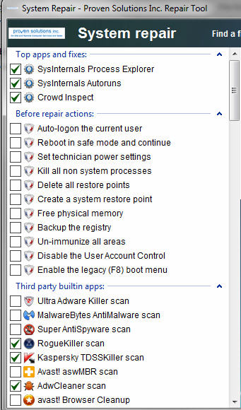

As the subject says I am having a problem with the 'Save Settings' of System Repair.
The issue has to do with the Third Part Builtin Apps in a settings that I have named '1000_AntiMalware_Standard.uvksr'.
In my example, I have check marked 'AdwCleaner Scan', 'Kaspersky TDSSKiller Scan' and 'Rogue Killer Scan'.
I have ordered them to the top of the Third Party Builtin Apps in the order mentioned above.
I click on 'Save Settings'.
If I now go back to Home > System Repair > Load Settings > '1000_AntiMalware_Standard.uvksr' ...
The three apps are checked marked and their order and placement at the top of the group may or may not be correct.
However, if I save the '1000_AntiMalware_Standard.uvksr' and restore it back I get:
Check marks OK
The order of the Third Party Builtin Apps is as per original and three chosen apps are not at the top of the list.
I hope that this makes sense.
System Repair > Save Settings > Supposed to Remember Order

This is due to my just beginning to use this s/w.
Please see 2 attachments.
The 'Before' is before I click on 'Save Settings.
You can see I have selected 3 of the built in Third Part Apps, moved them to the top of *that group*
and reordered them.

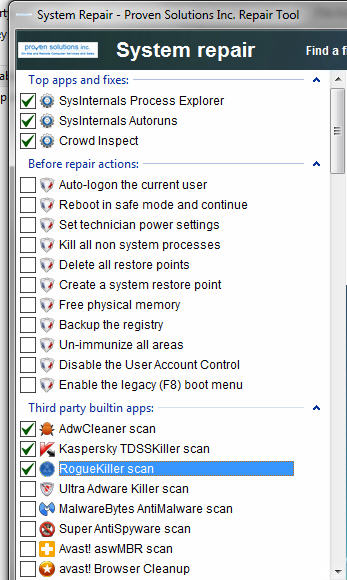

The 'After' attachment is after I have saved settings, gone back to home, clicked on system repair and loaded the settings for anti-malware.
As you can see - the same three are selected in Third Party Builtin Apps but their order has reverted back to the original before my tweaking.
Is this the bug that you are referring to?
- before.jpg (74.03 KiB) Viewed 6966 times
- After.jpg (70.65 KiB) Viewed 6966 times

Re: System Repair > Save Settings > Supposed to Remember Order
Oh, I see. The order in the built in third party apps group is hard-coded. I'm just allowing you to temporarily order them because I though it would be convenient.
If you want them to stay ordered you will need to move those to the top apps and fixes group. I'm beginning to think that maybe I should not allow to move those apps in order to prevent this type of confusion.
