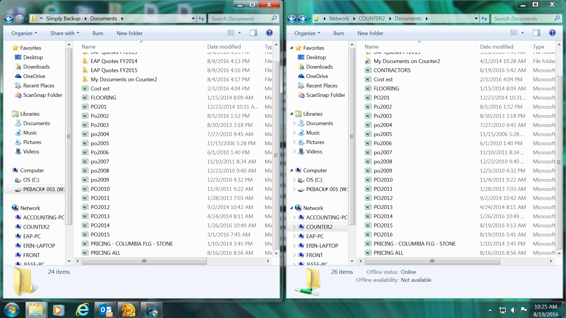

It appears that SimplySync does not back up all files and more importantly, does not inform the user that it does not copy certain files. I am including a side by side of the copied directory and the source directory.

I will have to wait till Monday to check those files for your suggestions. However, they were Excel spreads that were actually just "save as" files from ones that did copy. They also should not be marked system and on that computer I'm not it is set to show hidden files.... It could be but I don't remember needing to set that.
Re: SimplySync
I checked that file today and it was not read only or system. SimplySync simply just didn't copy it. Is there a way you would like to me to test it for you for get the result info you need?

Do you try to make backup on network? If yes than try to make backup on same computer but different partition/folder.
and I also observe in your pic that it doesn't copy the folder "My Documents on Counter 2" but it make a shortcut.. (or you do it intentionally :) )

It should have copied that folder exactly. It was a network folder but it copied most of it but not all of it. The word part is it left out files that were just like the ones it did copy. Like the 2015 and 2016 files. They are the same type of file.
