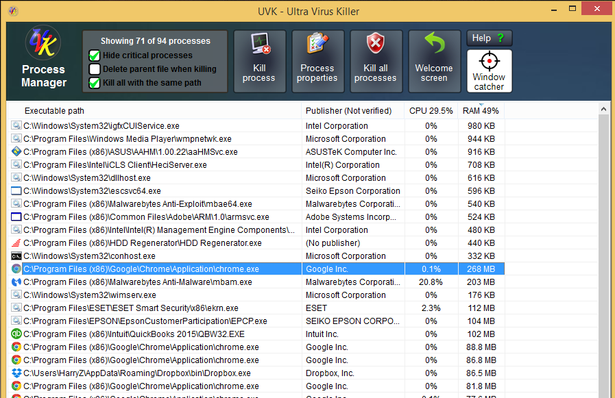

Hi. I'm a new user to UVK. Just downloaded the portable edition and started exploring. When using the Process Manager, I click on the RAM column header to sort by % RAM used, in descending order. If you look at the attachment, it's clear that the program is not distinguishing between MB and KB (this highlighted line should be at the top of the list).
Please add this to your 'to be fixed' list.

Ni Harry. Thanks for mentioning this bug, and welcome to the UVK forums.
I will see if I can fix it ASAP.

I was thinking this had been talked about before but I could not find it. It has been been kinda weird seeing it list things that way :)

Charger440 wrote:I was thinking this had been talked about before but I could not find it. It has been been kinda weird seeing it list things that way :)
You are right the problem has been talked about before.
I reported the problem, which also occurs in Smart Uninstaller, back in May.
viewtopic.php?f=4&t=1020&p=3017#p3017
