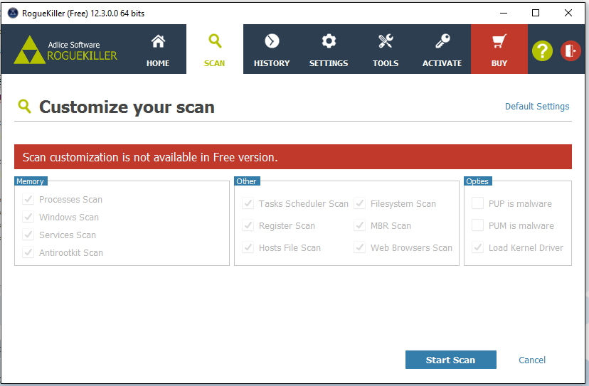

I am trying to automate RogueKiller Portable to open and start a scan.
However, I am stuck at the "->ClickWindowPos or ->ClickControl" I tried both but I couldn't get it to work.
When RogueKiller Portable opens, this screen appears:
I want to click on the "Start Scan" Button.

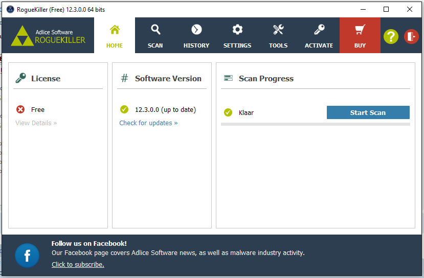

After that, this screen appears:
There I want to click on the "Start Scan" Button once again.
My script so far:

Re: Automate Scan
Hey Martin.
The window remains the same, so you should not use the second ->WaitWindow() call.
Try replacing ->WaitWindow(5) with ->Sleep(1000)

Re: Automate Scan
You can easily get the coordinates from the Log Analyzer's Control Info Tool. From the "Tools" menu, click "Control Info Tool"
Re: Automate Scan
I've just updated the coordinates in the System repair automation of RogueKiller. This should work for you:
Code: Select all
->WaitWindow(10)
->ClickWindowPos(720, 185)
->Sleep(1500)
->ClickWindowPos(640, 470)
Whenever the automation isn't working, please report so I update it ASAP. Thanks.
