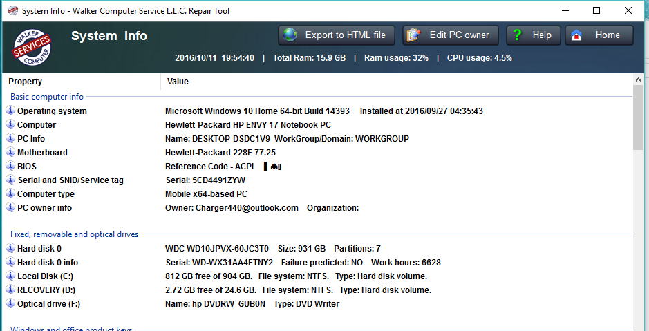

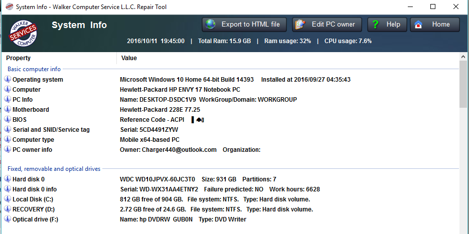

I don't know if it's the issue or not but I have seen this with 9.6.0 and 9.6.1. As you can see in the images it's an HP.

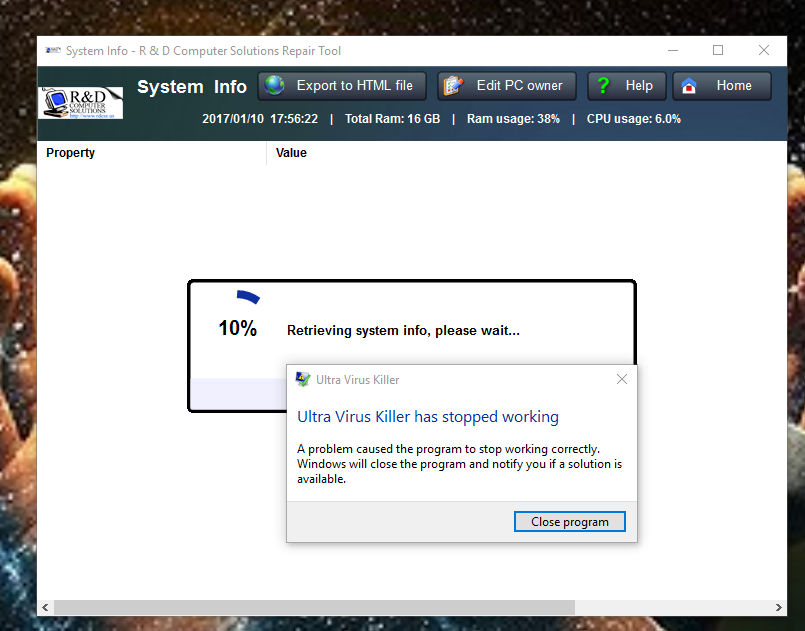

I am experiencing this issue.
Click on system info it starts doing its thing, then it errors out.
thanks for any help you can give.
I hope the system info below helps.
antivirus and and malwarebytes are all turned off.

I want to buy your software but I need the system info to work.
I plan to use it with pcrt.
thanks
Robert

I noticed when the system info is run, behind the error you can see it was at 10% done when it crashes.
I went ahead and bought the branded version of your software.
thanks in advance for your help.
Robert
