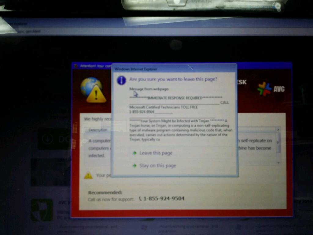

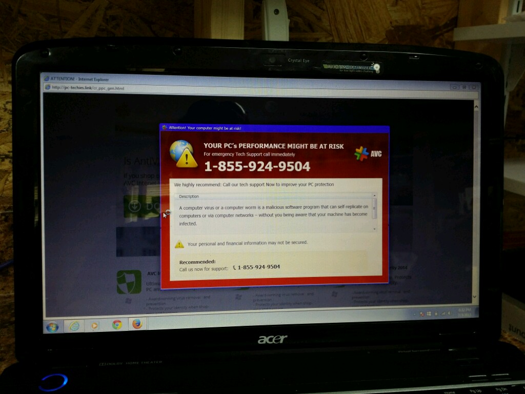

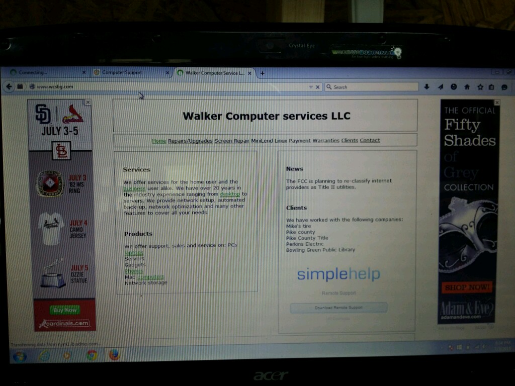

I'm putting more for information and discussion than complaining. The following pictures were from a computer I just cleaned. I immunized and immunization was still active when he brought it back.
Can immunization prevent this? Are we immunizing the right places? From the bugs it seems he decided to visit a page he should not have after getting it back from me.
Ad/Spyware issue
Ad/Spyware issue

Re: Ad/Spyware issue
Jim, the immunization and Execute prevent doesn't prevent all infections, even if all the areas are immunized. There are other parts of the OS that could not be ummunized. for instance, I could not prevent Windows services from being added because if I change the permissions of the Services key windows will no longer work properly.
The third picture shows Firefox. Chrome and Firefox are not immunized yet, as I mentioned in another topic.
On the firefox deal, I rmember you saying that but I was thinking this spyware/adware had install from the temp directory or should have anyway....... Anyway later today when I have tie to sit down and write I will elaborate more more on the other post you asked me about and I'll explain more what I meant about this one.
One thing that would help in cases like this one is to use the Process manager's window catcher to identify the path the program is being run, and post that path. Without knowing the path, it's impossible to say if something is wrong.
If the program runs from the temp directory, execute prevent does not block it, obviously.
