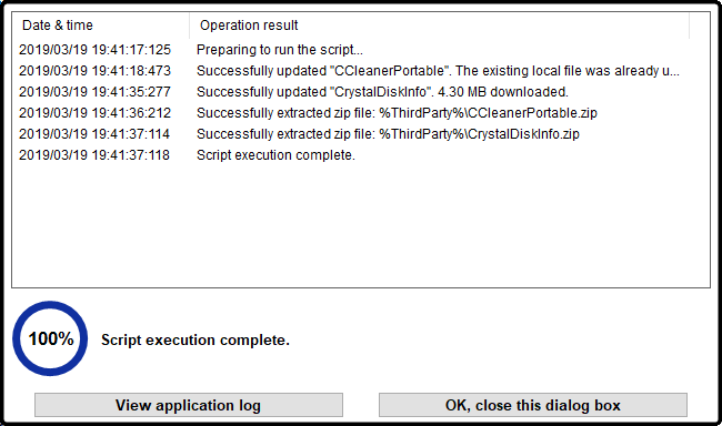

I just tested the following script:
Code: Select all
<UpdateSoftware>
%ThirdParty%\CCleanerPortable.zip | https://www.ccleaner.com/ccleaner/download/portable | start the download
%ThirdParty%\CrystalDiskInfo.zip | https://www.softpedia.com/get/PORTABLE-SOFTWARE/System/System-Info/Portable-CrystalDiskInfo.shtml | Softpedia
<UnzipFile>
And the result was as follows:
Tip: To easily get the download URL and link text, use Tech Tool Store's Create similar tool feature.
