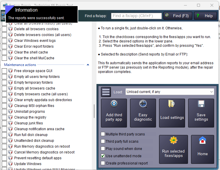

One more thing Fred, I'm sure it something I'm doing wrong. I've tested this many times on my machine and it doesn't work. I have the box checked in the UVKSR file to email me a report. However when it finished, I never get the report in my email. I have the option checked in the Reporting section with the correct email address. What did I forget to set up that is causing the email not to come through?

by Fred
Hi Fred.
I just tested the Send reports by Email or FTP feature from the System repair module and it worked fine. Are you able to send the reports from the Reporting module instead?
